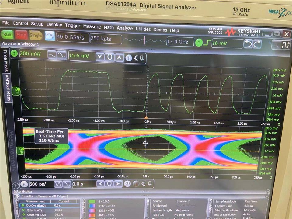

My customer use our 962 paired with 935, and the CAR OEM asks them to provide the eye diagram.
They test 962's CMLOUT, but the result is not good. For the CMLOUT test, we followed datasheet's code example, do we have any other register configuration? Do we need to turn off the spread spectrum.

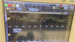

In addition, if we test the 962's RIN+/- directly and turn off the back channel, we can't see the eye diagram as the second picture. Do we need any special register configuration for this method?

  • Hi Sherry,
    The CMLOUT gives the FPD-Link signal after it is recovered by the AEQ circuit.  Therefore it will still have spread spectrum and probably not be captured on the scope very well.  I would recommend that you remove the SSC for a proper eye diagram.
    As for seeing the signal as it comes through the coax cable, recall the AEQ circuit I mentioned above.  The AEQ will amplify and recover the FPD-Link signal which the scope will not do.  You should always read on the CMLOUT pins to see what the deserializer is actually recovering.

  • Hi Sherry,
    Are you asking if you can measure the FPD-Link signal directly from the cable or at the actual pin?  Either way I don't think it would be very meaningful and you probably wouldn't see an open eye.  The reason you need to measure it using the CMLOUT pins is because the DES has internal circuitry to add gain at the FPD-Link frequency and open the eye.  By measuring at the CMLOUT pins you are basically seeing what the DES sees which is most important.

  • Hi Sherry,
    You can measure at the DOUT pins of the serializer but again it would not be very meaningful.  Really the best way is to see the eye as it is seen by the deserializer.  You could compare the opening when using different lengths of cable to see the affect but you could also use the MAP tool that shows how many available AEQ settings.
