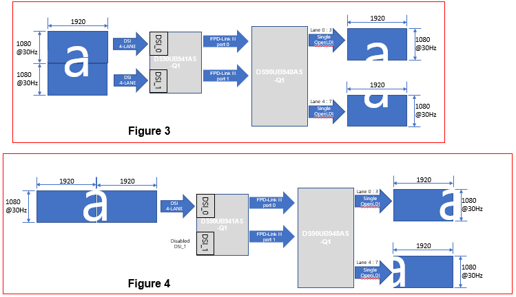

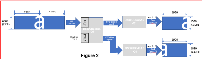

In this case, is it split into two 1920 * 1080 @30Hz screens as shown in Figure 2 below?
[FIGURE 2]
In addition, please check whether the output configuration as shown in Figure 3 and Figure 4 below is possible.
(In any form, output from one DS90UH941AS-Q1 should be two 1920 * 1080 @30Hz images.)
[FIGURE 3, 4]
