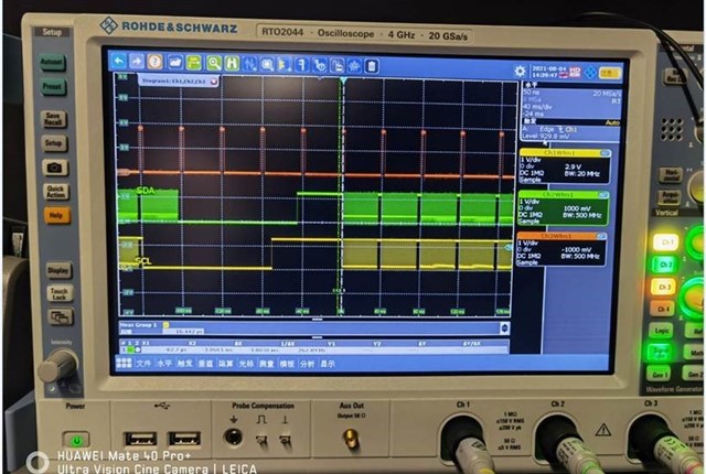

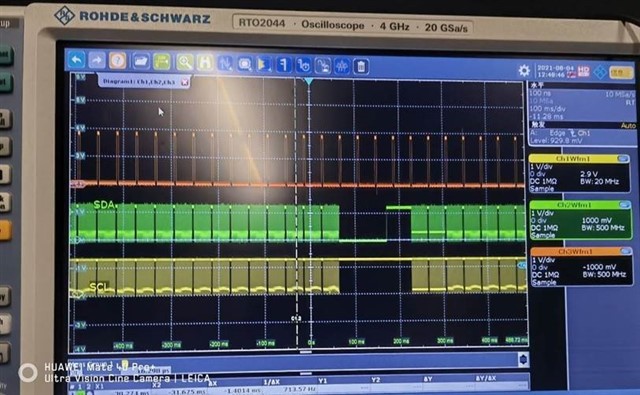

My system is Camera-935-962-ISP. Only one Camera attached during test. If power down camera and then power up camera, ISP cannot recognize CSI signal from 962. However, if there is 962 CSI reset between camera power down& power up, ISP can recognize CSI signal from 962.
NOTE: "962 CSI reset" mean: set register 0x33 to 0 to disable and then set to 0x3 to enable CSI
Below is captured CSI signal. Green is CSI data 0 signal from camera to 935. Yellow is CSI data 0 signal from 962 to ISP. Orange is frame sync which you can ignore.
I found during camera power down, CSI data 0 of 962 are hold to high (other CSI data and clock are similar). With CSI disable, CSI data jump to low, then jump to high when enable CSI. What's the purpose for this logic? Anything else is done during CSI disable &then enable?
ISP side is also checking the problem. However, need your guidance to give us some hint.
I also attached register setting below.
Great thanks

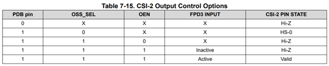

    If the CSI_ENABLE bit is set to 1 and no video input is coming from the serializer, then the CSI-2 pin output state will be LP11 (inactive). In this inactive state, the positive and negative pins of each data and clock lane will be held HIGH until valid video data is inputted. You are experiencing expected behavior.
    In the next image, CSI data is brought LOW when you disable the CSI_ENABLE bit. When you disable the CSI_ENABLE bit, the CSI-2 pins are put in a Hi-Z state. Along the pins, there should be a resistance tied to ground, which is why the signal will fall to LOW after the Hi-Z state is enabled. You are experiencing expected behavior. There is a table in the UB962 datasheet which demonstrates this point:
    And in regards to why you would need to perform a "CSI Reset" in your application, it should be based on what your ISP is expecting. In other applications that use the UB962, there is no need to enable/disable the CSI_ENABLE bit in register 0x33, unless you are configuring certain register settings. For normal operation, you would leave this bit set to 1.
    I recommend following up with the ISP side and asking them what the ISP is expecting. This is likely an issue with how the ISP reacts to the sudden LP11 state that the UB962 outputs, once the camera powers down.

    The "CSI-2 High-Speed RX Enable" 0x22 register is a RESERVED register, which TI does not recommend modifying. The details are also not available to the public. What are you expecting to test by modifying this register?
    The issue seems to be related to how the ISP reacts to the LP11 state after the camera powers down, so modifying this register does not seem necessary.
