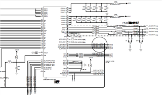

  • Hi,Logan,
    The schematics like this.

  • Hi Guanhua,
    Thanks for the schematics, I still have a couple things I need clarified if you don't mind:
    I don't see where the I2C pull ups are on these schematics. Can you clarify what the pull-up values are on each I2C pin, as well as if there are any additional capacitance/series resistance is being used.

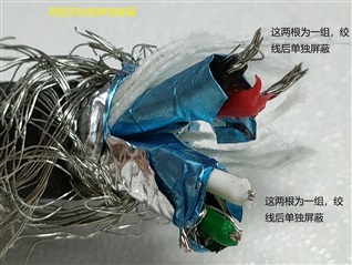

  • If the cable is very short,less than half a meter,it is good.Or,if the cable is shelding good each other,I2C  error could be disappear.As shown in the figure.
    we use the resistance value is 2.2K Ohm,pull up to 3.3 volts.There is a 33pF capacitance and 100 Ohm series resistance each I2C pin on the slave unit 948.
