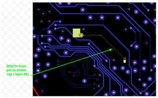

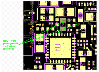

In the layout the traces are routed separately:
DOUT-   between serializer pin 13 and via to GND (bottom layer)
DOUT+ from serializer pin 14, via to layer 8 (with impedance control at 50ohm) and to via to the top layer.
DOUT+ AC cap (c19) to coax connector J1 (top layer)
Please review it.

    The AC coupling capacitors (C19 and C20) should be placed on the same layer and placed as close as possible to the UB953 DOUT+/- pins. This is done in order to minimize the length of the coupled differential trace pair between the pins and the capacitors. C19 should not be placed that far away.
    In the Layout Examples section of the UB953 datasheet, it states that if DOUT+ is routed on an inner layer, then routing DOUT- loosely-coupled to it will not provide a significant benefit. But if DOUT+ is routed on an outside layer, then there is a significant benefit in routing it alongside the DOUT- trace. Routing the DOUT traces together on an outside layer will introduce a differential nature that will cancel out any common-mode noise that may couple onto the signal traces from the environment. This will improve the EMC performance of your system. The DOUT+/- traces do not need to be length-matched in COAX mode, but you should aim to minimize the trace length that DOUT+ is routed without being loosely-coupled to DOUT-. The traces must also be loosely-coupled (S>3W) in order to prevent each DOUT trace from coupling onto each other.
    Since the DOUT+ trace moves to an inner layer (Layer 8) and then to an outside layer (Top Layer), I recommend that the DOUT- trace be routed alongside DOUT+ all the way up to the connector, in order to improve EMC performance.

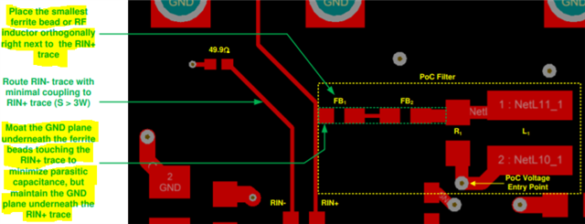

    5. Since the DOUT+ trace travels along an outside layer, then we strongly recommend that the DOUT- trace be loosely-coupled to the DOUT+ trace, all the way up to the connector. Otherwise, there is a high chance that there will be EMC performance issues that can affect the video data being transferred and negatively affect normal operation. Terminate resistor R2 next to the connector.
    6. There is a PoC circuit and ESD diode in your design. Make sure that the landing pad of the touching Ferrite Bead in the PoC circuit is orthogonal to the DOUT+ trace and not overlapping. Since the DOUT+ trace requires a tightly-controlled 50-Ohm (+/-10%) impedance, we require the landing pad of the Ferrite Bead to just-touch the the DOUT+ trace and to have the reference ground plane underneath the landing pad in an adjacent layer be removed. This minimizes impedance mismatch. We also recommend to do the same for the landing pad of the ESD diode along the DOUT+ trace. See the layout guidelines from the deserializer datasheet for more information. The example below is from the UB960 datasheet.

    8. The width of the DOUT+/- traces must be the same throughout, in order to prevent impedance mismatch. I noticed that the trace width of the DOUT+ trace increases after the PoC circuit.

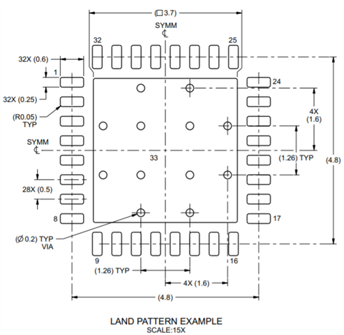

    10. The DAP provides the dominant thermal path for the UB953. Follow the Land Pattern Example in the UB953 datasheet for the even placement of ground vias underneath the device's DAP:
