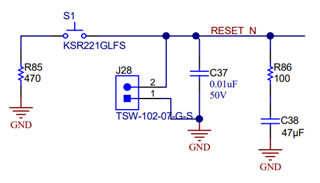

Hi Srinivas,
Can you share an image with all supplies individually ramping as well as reset? It seems like since a reset is needed after powerup, reset is not rising after all supplies have ramped. Can you try the following RC network on the reset pin?
Lucas

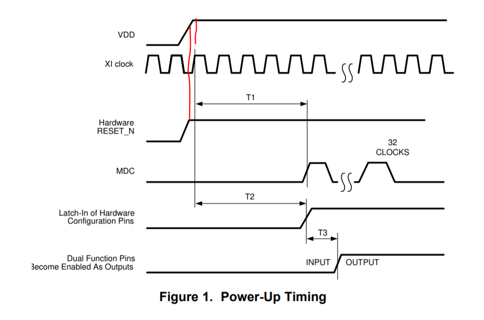

Hi Lucas,
As the POR is generated by PHY itself I believe the reset captured on the board doesn't represent the POR generated by the PHY.
As the RESET_N pin has the pull up on the board, it is raising along with +3.3V_ETH.
Please see below power-up timing from the datasheet. It doesn't give any info on the POR.
Srinivas
Hi Srinivas,
Delaying reset using the processor will make your power up sequence more robust, is this feasible given your setup?
