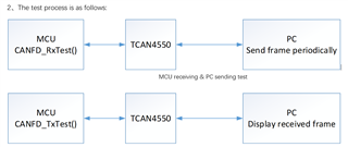

    The hardware setup in this test have shown in below diagram:
    Detailed test process description
    1Receiving debug
    (1Signal from PC
    Figure 1
    As shown in Figure 1, the length of the transmitted signal is 64 bytes (DLC = 64), the ID is 0x179, and the values of the first 12 bytes are 0x00 ~ 0x0B.

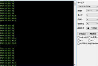

    (2received data on mcu
    Writing test function “void CANFD_RxTest(timeout_t *timeout)”, See the file “TCAN4550_app.h/TCAN4550_app.c” for details. First, verify whether the received DLC and ID are consistent with those sent by PC, then verify whether the value of the first 12 received bytes is consistent with the value of the transmitted bytes, print the verification information of each byte through the serial port, as shown in Figure 2, in each frame of received data, the first 8 bytes are correct and the last 4 bytes are wrong.
    Figure 2
    2Sending debug
    (1) Signal from MCU
    Configure the length of the transmitted frame to 12 bytes (DLC = 12), the ID is 0x180, the first byte is the counter value, and the counter value of each frame is increased by one,and the values of the last 11 bytes are 0x01 ~ 0x0B.Every 200ms a frame is send.
    (2) received data on PC
    See the video “received data on PC.mp4”, it can be seen that the received ID and DLC are correct,the value of the first 8 bytes is also correct, the first byte shows the counter values incremented one by one. But the last four bytes are incorrect, the displayed value will jump,but the values are always the same.
  • Hi Gabriel,
    Thanks for sharing the extra info and video. It looks like the pattern of the last four bytes is repeating so I suspect it has something to do with the incrementing value. My suspicion is that this data is actually the CRC segment of the CAN frame. This may be caused if the frame itself is being limited to a data length of 8-bytes.
    Can you confirm that the CanfdTxHeader variable is being configured (via CANFD_Config() before it is written to the buffer? If this is not done, the default header will be for a classic CAN frame which limits the data length to 8 bytes. The frame must be configured with the BRS and FDF bits enabled to allow for larger data lengths.
