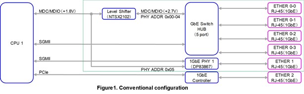

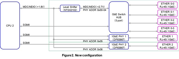

Our customer use this device follow constitutions.

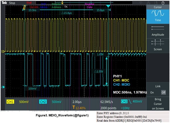

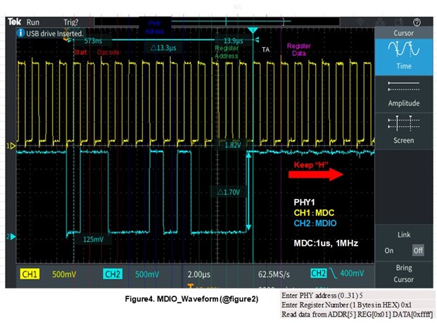

In figure1, we can observe accessing to register of DP83867. Figure3 show the MDIO Register Access at figure1.
But, in figure2, we can't observe accessing to register of DP83867 at PHY1. Figure4 show the MDIO Register Access at figure2 PHY1.
In figure4, Register Data is 0xffff.

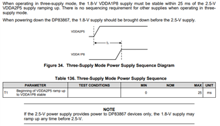

    Your comment "When PHY2 is not connected, PHY1 can't read too" seems to contradict your original comment "In figure1, we can observe accessing to register of DP83867." Can you clarify whether you can read/write registers when only 1 phy is active?
    This is the requirement for supply ramps in 3-supply mode. Can you also share a supply ramp diagram including reset for your design?

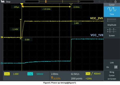

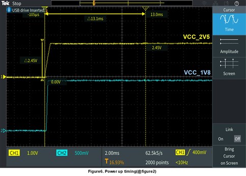

    Follow waveforms show startup timing of 2.5V and 1.8V supply in figure1 and figure2 without RESET.
    If there is some requirement for RESET, let me know.
    teritama
  • Hi Teritama,
    Can you share the same timing diagram but include reset and MDC lines? You can refer to Figure 1 of the datasheet for reference.

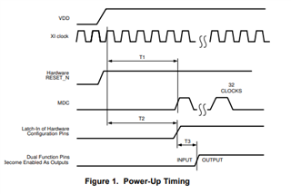

  • Hi Teritama,
    Based on Fig 1 of the datasheet, MDC should be kept low before startup. Are there any PUs on MDC that could be driving it high?

  • Hi Teritama,
    It looks like MDC is high when it's expected to be low until time T1 (200 ms).
    Can you try removing the PU on MDC so it isn't pulled high before startup?

    When use the USB-2-MDIO tool, We can access the register (ADDR5) on PHY1 even though the MDC was high before startup.
    Figure 9 shows the waveform when using the USB-2-MDIO tool.
    Does MDC need to be Low before startup? Do you have other information about MDC/MDIO requirement?

     And we can't isolate CPU, because the pattern of CPU2 to PHY is connected in the inside layer. When use USB-2-MDIO tool, we stopped the MDIO of CPU2 by this terminal being Open-drain.

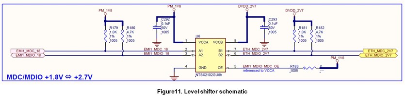

    In addition, the customer checked the waveform when the level translator(NTSX2102) connected to MDC/MDIO is disable.
    We could observe the access to MDIO when both damping resister 10Ω and 62Ω.
    I think this level shifter's condition is related to this matter.

    It looks like when a 10 ohm damping resistor was used, there was some glitch in the MDC waveform, where the waveform quickly increases again before ramping down to 0. This could be the cause of some error accessing MDC/MDIO. In your most recent post you mention "We could observe the access to MDIO when both damping resistor 10Ω and 62Ω." Does this mean you now have register access for both damping resistors?
    It's possible the level shifter is placing some additional loading on the MDC/MDIO lines. Can you provide a schematic of the level shifter circuit?

  • Hi Nikhil,
    ⇒Yes, when the level shifter is disable, we have register access for both damping register. When  the level shifter is enable, we couldn't have access for only 10 ohm damping register.
    ⇒Follow figure is the schematic. EMI1_MDC_18 and EMI_MDIO_18 ports are connected to CPU and PHY.
    teritama
  • Hi Teritama,
    Any particular reason why a different value chosen for MDC vs MDIO pull ups on both the A and B side of the level shifter? If I'm understanding correctly, the damping resistor would be in series with the MDC/MDIO lines, correct?
    Thank you,
    Nikhil

  • Hi Nikhil,
    ⇒I'll check to the customer if there  is any reason this pull up setting. Is it possible this pull up mismatch cause any issue?
    ⇒Yes, you saying correct. the damping resister is in series with the MDC/MDIO line.
    teritama
  • Hi Teritama,
    The strength of the pull resistor will determine how closely tied the signal is to the supply rail. There is a small possibility that having pull ups of different strengths (it looks like there is a 3x difference here) leads to enough of a difference in the signal levels between MDC and MDIO to cause issues, hence why a damping resistor in series may help. Though these should be a fairly robust interface. Please let me know if using the same pull-up values for both MDC and MDIO help resolve this issue.
    Thank you,
    Nikhil

    We checked result when the pull up resister MDC/MDIO are replaced to same 4.7kohm at both of case the damping resister is 10ohm and 62ohm.
    The issue didn't resolve. We observed the waveform same figure9 and figure10 of this thread.
