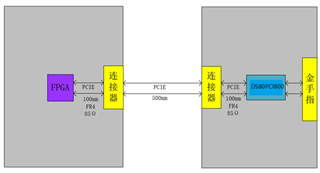

Part Number: DS80PCI800
The picture shows that the model of our application is different from the typical application, please help to confirm whether DS80pci800 can meet the requirements of this application.
Hi Ping,
DS80PCI800 should work in your block diagram. Suggestion is to use DS80PCI800 - this part has been qualified by PCIe SIG.
Also, please provide 3-4dB minimum loss on input of the DS80PCI800.
Given your connector and transmission media, it is a good idea if you can do system integrity analyses using s-parameter of your connector and pcb material to make sure there is enough eye opening.
Regards ,, nasser
Nasser,
The PCIE Card we designed, one end is Server, the orther end is FPGA with a long cable of 300mm/500mm length.
In our block diagram, the DS80PCI800 device is placed on the middle of the TX lane.
The Insert Loss of the input is about -10dB total, within -15dB.
The Insert Loss of the output is about -10dB total, within -15dB.
Above, Can PCIE RePeater Work well,or use PCIE Retimer to replace.
Thanks.
Greetings,
A redriver like should be able to handle this. Please note in Gen3 PCIe root complex and end point - without a redriver - should be able to handle 22dB total channel loss. In your setup you have 30dB total channel loss so the redriver has to compensate for 10-11dB and the system will do the rest. DS80PCI800 should be able to handle this much loss.
