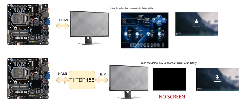

Hi Sirs,
My customer used the TDP158 to develop an HDMI re-driver board(HDMI RX side has pull-up 49.9Ohm to 3v3), when they connected TDP158 from M/B(Intel H410 chipset) to Monitor, there is no BIOS screen shown.
If they connected M/B to Monitor directly, the BIOS will be displayed, you can refer to the setup description as below figure.
How to fix this issue? please advise. Thanks!
    Can you please send the schematic for review? Can you please measure the TDP158 clock output?
    For this particular application, the DP159 will be a better choice than the TDP158 with its adaptive equalizer. Any chance they can replace DP158 with DP159? Please see this app note on the implementation difference between the two, https://www.ti.com/lit/ug/sllu291a/sllu291a.pdf.

    Can you please measure the TDP158 clock output? => The customer can not measured any clock output when the BIOS no screen output.
