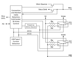

Hi Chuck, Thanks. I got it. But I sill have a question. When TPS25750 is in DRP mode (Battery OTG mode) , it can automatically select the power path between PP5V and PPHV, which depends on the USB-C negotiation. Is it right?
From this general model of USB-C negotiation, In only source, the switch will be always connected to Rp.
So in this situation, The PPHV power path of TPS25750 can not be select. The PP5V power source will be always turned on by default.
Is my understanding correct?
You understanding is correct. The GUI will only allow you to configure the TPS25750D into a 5V output capable DRP that will match the figure that you have show.
It will fully execute all of the USB PD control and configuration to execute any require role changes within the 5V source and 5-20V sink range.
