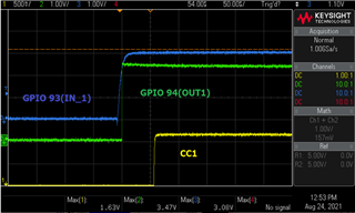

Hi team,
We appreciated your great support!
May I ask why the CC PIN has not been activated, but the IC already knows that something is inserted as below?
Is it related to the DRP operation principle of the IC?
