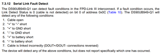

DS90UB949-Q1 has the following Fault Detect instructions at datasheet 7.3.12 Serial Link Fault detect, and I wonder if the DS90UB948-Q1 also has this capability?

  • Hi Amy,
    • The UB948-Q1 has a similar GENERAL_STATUS register (0x1C), however unlike the 949 GENERAL_STATUS register (0x0C), this register does not report errors. The full description of this register can be found in section 7.7.1.29 of the 948 datasheet.
    • The application note SNLA131A has details about I2C communication using FPD-Link III with bidirectional control, and may be useful to understand the potential speed of the signal in question.
