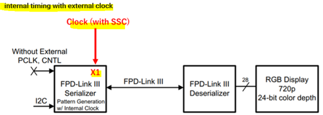

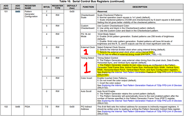

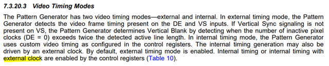

Hello team,

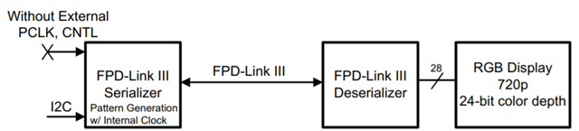

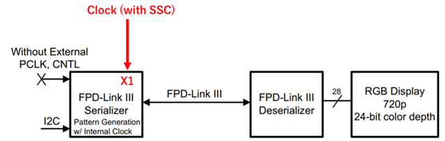

Regarding 949A, to reduce the EMC customer would like to apply the SSC to the pattern generation.
If customer put the oscillator with SSC to the pin X1 (optional oscillator input), is it possible to output the pattern generation with SSC?
We might be confused but the background to ask this is below.
Or any other good method?
