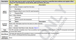

You will need to use 4CC (4 Character Code) I2Cr command as described here.
Basically MCU sends 4CC "I2Cr" Command over I2C1 of PD Controller -> this command causes PD Controller to send I2C Read Command over I2C3 to TPS55288 -> MCU reads the data read back from I2Cr command in the DATA register.
To execute a 4CC command, you first need to send the input data to the Data register (0x9 for Data1). After sending the input data to the data register, the 4CC command can be sent to the CMD register (0x8 for CMD1). So in your case the data is the slave address, register address and the # of bytes as described in the table below and the command will be the hex of ASCII "I2Cr", see attached excel sheet for more detail.

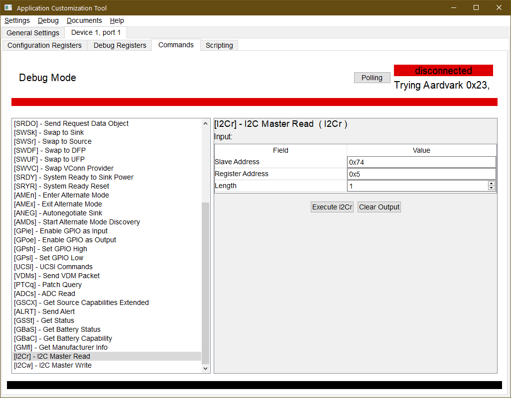

Using Application Customization Tool, I used the following values to read one byte data from register 0x05 of TPS55288 with I2C3 address of 0x74 (3A << 1), I expected to received the default value of 0xE0 but it is not working:

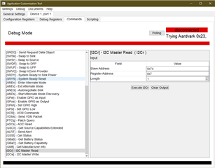

The second way:
The I2Cr command is not working either, and it causes disconnection:
All of these happening whilst the 'I2C Controller Events' are working perfectly.
Q3: Is there any settings to allow the I2Cr command to work?

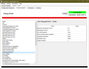

Can you read the I2C address when you click on "Sweep I2C address..." from the Adapter menu with Aardvark?
Dear pdjuandi
Q1: Is this TPS65987DH or TPS65987DJ, can you send me your pjt file?
Answer: it is a TPS65987DDH device.
Q2: If you are using the GUI debug mode, it needs to be connected.
Answer: Of course, BEFORE I run the '[I2Cr] - I2C Master Read' command in debug mode to read I2C3 at address 0x74, the Application Customization Tool was connected. AFTER I push the 'Execute I2Cr' button, it disconnects. The same will go for CMD1 & DATA1.

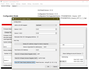

Q3: Can you read the I2C address when you click on "Sweep I2C address..." from the Adapter menu with Aardvark?
It is 0x23 (Image bellow)

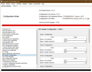

My TPS65987D address on I2C1 is 0x46 (0x23 << 1) and the TPS55288 address on I2C3 is 0x74 (0x3A << 1).
Also in image bellow, I set TPS55288 address in register 0x64 and is working fine.

I don't see your pjt file, can you confirm you have "I2C3 Enable as Master" checked in register 0x27? If you do can you capture the I2C transactions and make sure you received an ACK for the transactions?
If you are not reading correctly after having the "I2C3 as master" checked from the GUI debug mode, try using the steps from the above excel sheet.
Peter
Dear Peter
In my previous post, I said TPS55288 with address 0x74 is working, it means it has been enabled in register 0x27 (image bellow).

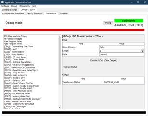

Then I thought let's do an I2Cw command (Image bellow):
It says successful but, again, NOTHING BEING SENT via I2C3 pins when I use I2Cw command either.

I did the following I2Cw command:
(Slave Address: 0x0, Length: 0, Data: 0x1)
Then at I2C3 pins on my CRO, I can see one byte which is 0x00 (image bellow)
More experiments:
If I send (Slave Address: 0x1, Length: 0, Data: 0x1), I will get 0x2 on my CRO (bit 0 is write as 0)
If I send (Slave Address: 0x2, Length: 0, Data: 0x1), I will get 0x4 on my CRO (bit 0 is write as 0)
and so on.
In these experiments, if I set 'Data' field value to 0x0, then the Application Customization Toll disconnects with no data on CRO.
In these experiments, the 'Data' field SOULD be 0x1, otherwise I don't see anything on my CRO.
In these experiments, it seems that the value of 'Length' field could be ANYTHING, it has no effect.

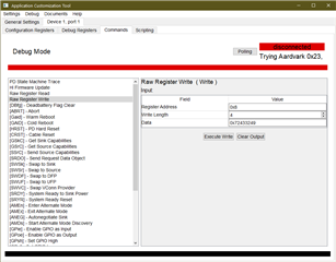

When I put 0x01057403 into Data1, the write is successful:
When I put 0x7243324904 into CMD1, it seems write is successful but, I am getting exception:
When I close the Exception window, the Application Customization Tool closes too.
That 0x444d4321 means 'DMC!' or !CMD, and I don't see any signals at I2C3 pins on my CRO.
I am using Application Customization Tool version 6.1.2, I am not sure what you are using!?

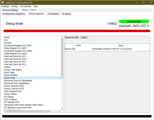

I appreciate it. Here the images I captured:
1. Successful connection from Application Customization Tool version 6.1.2 to my custom board's TPS65987D's I2C1 pins at address 0x23
2. My TPS65987D's device info

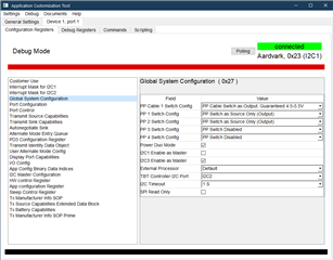

4. I2C3 enabled as Master

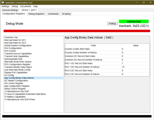

5. I2C slave address for I2C3 set to my custom board's TPS55288's I2C pins at address 0x74 which is 0x3A << 1
6. I use 14 indices in my configuration which all are working successfully.

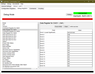

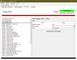

7. Writing into DATA1 register 0x9, as you instructed in 'I2Cr_4CC_cmd_example_987_majid.xlsx' document
8. Here it is to confirm the DATA1 has been written successfully
9. Writing into CMD1 register 0x8, as you instructed in 'I2Cr_4CC_cmd_example_987_majid.xlsx' document
9.1 Before pushing the 'Execute Write' button
9.2 After pushing the 'Execute Write' button
9.3 There is no communication after previous step 9.2

Question: "Is it possible for a host MCU, to send data/command to I2C3 over I2C1? (Something like sending data/command to SPI via I2C1)"
And the answer is yes. According to the following highlighted text in yellow:
Again you are not reading my post completely, just picking something from the context and just repeat and repeat the same answer.
FOR THE LAST TIME: The communication from MCU or Application Customization Tool via I2C1 IS OKAY. Why you keep capturing signal at I2C1 !?
The TUNNELING between I2C1 and I2C3 IS NOT WORKING.
What is the purpose of the I2Cr and I2Cw commands?
"What is your pending issue now?"
THE PROBLEM IS I2Cr and I2Cw commands, THESE COMMANDS DO NOT DO WHAT THEY SUPPOSE TO DO.
You said: "And if I may ask what is your application here. I2C3 master use is mainly PD controller to control devices like USB muxes etc for simple I2C writes from I2C master table. It is not meant for tunneling from I2C1 to I2C3. There could be conflicts which can cause issue."
But highlighted text in the above image says exactly the opposite. It should work. My question is why is not?
Majid,
I am guessing you have looked at this post (+) TPS65987D: Documentation for "I2Cr" - Interface forum - Interface - TI E2E support forums already? In this one you can see that I2Cw command is working correctly, gentleman there had issue with I2Cr command.
Do you have a way to capture your I2C3 traffic on a logic Analyzer like Saleae? That might help me to see what issue you are facing or if there is some formatting error.
I don't know why we are going in a loop.
On the post you mentioned, Emma has provided 3 steps.
The problem is after step 1 which is: "1. You will first write the I2Cr CMD", the TPS65987D becomes non-responsive and I have to reset the TPS65987D (as I mentioned in my previous post; step 9.2). There is no point to do the step 2 which is: "2. Then you will read the CMD register to verify CMD"
I am sure that gentleman; 'Eriks', just gave up, as I did.
The bottom line is, the I2Cr is not working on TPS65987D and TI don't want or has no interest to fix it.
