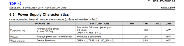

1.TDP142's maximum working current ?
2.TDP142's maximum power consumption?
(there are only typical ,not max)
For power supply budgeting, please use 255mA max @ 85C,3.6V as the max power number.
