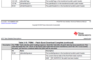

TPS25750 datasheet SLVUC05 – NOVEMBER 2020 seems to be missing bit ranges from PBMc command, between pages 45-46
rpBundleSignature 55:48 -> rpPatchHeaderCrc 95:64
What are bits 64:56?
Part Number: TPS25750
