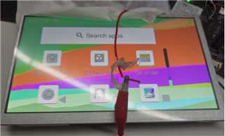

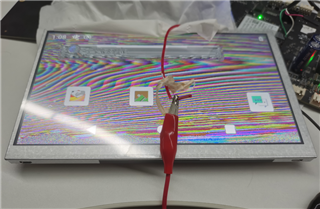

Use SN65DSI83 to achieve single-channel DSI to single-channel LVDS。Mipi signal is normal, but LVDS signal cannot be measured after entering the chip。
Can you give me some help?

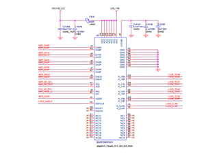

Can you please provide schematic and DSI83 register dump?

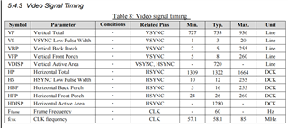

Are you using the DSI tuner to generate the DSI83 registers programming value? Comparing between the dump value and the panel datasheet, it looks like the dump value does not match with the value in the panel datasheet.
Please see this link on using the DSI tuner to program the register value, https://www.youtube.com/watch?v=w3fY_Mf2YiA.
David
I don't see an issue with your DSI programming. One thing I don't understand is the Htotal does not equal to Hsync_pulse_width + Hfront_porch + Hback_porch + Hactive in the panel datasheet.
