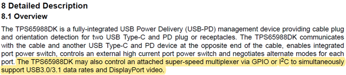

We would like to control Mux by I2C like a I2C3m of TPS65994AE.
Is I2C3 of TPS65988DK the same function as I2C3m of TPS65994AE?

The two parts have very similar control capabilities. They both support I2C events based on PD events.
The I2C Events between the two parts a very, very similar, but you will have to review the TRM for the 988DK because they are named differently and different ones are supported.

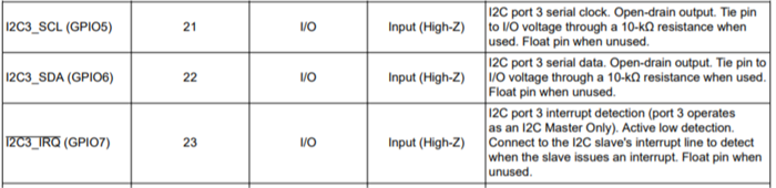

I confirmed datasheet of TPS65988DK but I can’t I couldn't judge if " I2C3m " and " I2C3" are the same.
And, can TPS65988DK control TUSB1046(Mux) by I2C?
I guess that TPS65988DK can control Mux if I2C3 is I2C master.
Is my understanding correct?

You can refer to this application note: Using I2C Master in TPS65987D and TPS65988 PD Controllers on how to perform the I2c control for the 988DK variant
