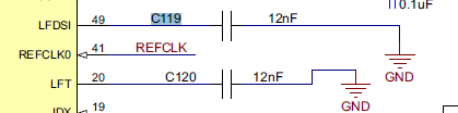

In datasheet, recommend capacitor is 10nF. However, in EVM, the capacitor used is 12nF. Which value is better for the customer to follow?
Thanks!
Thanks!
Hello Cathy,
10nF is the value we used during validation. If you do not have 10nF you can use 12nF as well.
