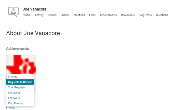

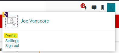

  • Hi Fusanobu,
    I may be mistaken but I thought that you accepted my request.
    On the top right corner of the web page you should see the person icon for your profile. Then click 'Profile'.
    then navigate to 'Profile'.
    Once you are on your profile page, click on the 'friends' drop-down menu. Then click 'Requests to Review' and accept my request.
    Once complete, at the top right corner of the home page you should see this messages icon and this is where we will communicate.
    Please let me know if you need any additional help/assistance accepting my request.
