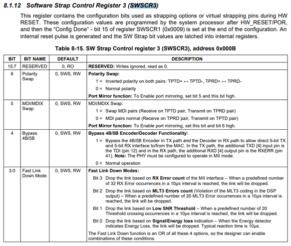

The TLK110 supports Fast Link Down mode. In this mode, T1 window is shortened , in most cases less than 10μs. In this period of time there are several criteria allowed to generate link loss event and drop the link.
What happens if the four setting items are disabled individually?
If you set it to OFF, I think that each detection operation will be different.
Can you tell me how the error detection period and the threshold of the error count change?
