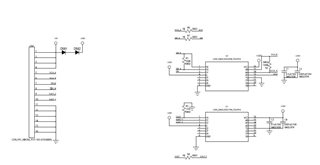

Please help to check schematic using SN65LVDS31 & SN65LVDS33PW.(as below pic)

I don't see an issue with the schematic except why you are powering the device at 3.6V, and not at 3.3V?
David
The SN65LVDS31 VCC min is 3.0V, nominal is 3.3V, and max is 3.6V. If you operating at 3.6V, you leave no room for any power supply fluctuations. And if you exceed the recommended operating conditions, the electrical characteristics are no longer guaranteed.
David
I don't see an issue with the schematic but I would again ask for the VCC to be 3.3V, and not 3.6V.
David
