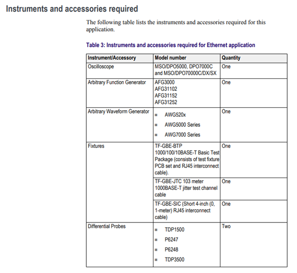

My customer report the compliance test result of Test Mode5 Transmitter Peak Differential Output is out of spec, see attached report.
The spec upper limit is 2.2VPP, but they got 3.166VPP.
Customer ever tried to modify LDG_CTRL1 to -16% and the result is also failed, became 2.571VPP.
May I know how to resolve this issue?
