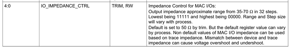

There is IO_IMPEDANCE_CTRL setting of IO_MUX_CFG register.
It is impedance MAC IOs, does it contain SGMII IF?
Kind regards,
    This setting is only for RGMII and GMII (64-pin device only).

    ->We are sorry that the customer uses DP83867CS(48pin). We have typo.
       DP83867CS is 48-pin device, so is it impossible to configure using IO_IMPEDANCE_CTRL setting?
       As the background of this question, DP83867CS's datasheet shows the same as IR's one like as follows;
       In case of DP83867CS, we can select SGMII IF.
       Therefore, dose IO_IMPEDANCE_CTRL setting of IO_MUX_CFG register correspond for SGMII_SOP/SON pins?

    This register setting applies to RGMII operation for all DP83867 packages.
