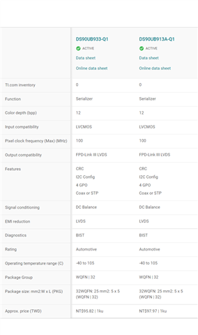

There is currently a new project" BSIS application "!
Customer would like to use DS90UB913-Q1!
Could you share what deference between DS90UB933-Q1 vs DS90UB913-Q1?
I want to recommend products suitable for customer. THX

Hello Kygo,
• The 913A and 933 are very similar. They are drop in and register compatible with following exceptions:
a. 933 does not support lower PCLK frequencies < 50 MHz
b. 913A does not support higher PCLK frequencies 12b /100 MHz
c. 913A does not support CLK out divide by 4 in register bit 0x29 [5]
