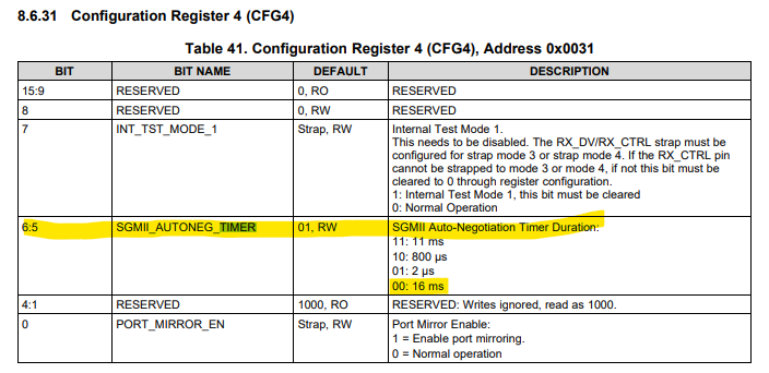

    Can you please also try setting the SGMII_AUTONEG_TIMER to '00b'? This will correspond to a 16ms Auto-Negotiation timer for SGMII.

    I tried changing the specified field in register 0x31, with no discernable difference.

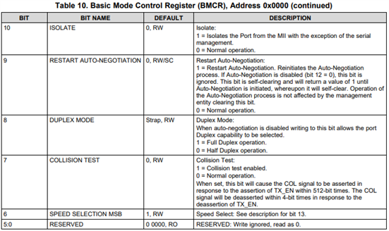

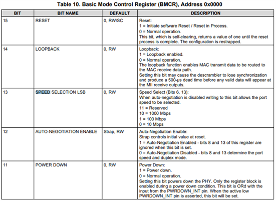

    Would it be a viable path forward to turn off autonegotiation and specify a fixed configuration? If so, what would be the correct bits to set for 1G Full Duplex?
    Please have a look at register 0x0000. You will be able to set the DP83867E to 1G full-duplex with auto-negotiation disabled in this register.
