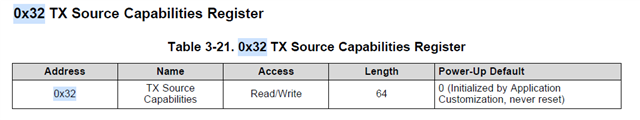

Is it possible to change the source capabilities of a PD source before it's connected to a PD sink? I'm thinking this should be possible by updating register 0x32; not sure if this brings any consequences, though.

    You could offer as much power the system can provide on 0x32 with different PDOs. Therefore, when a PSU is connected, it will only request the highest power that it can handle, assuming it is a compliant device.
    Are you programming the PD configurations to an EEPROM?
