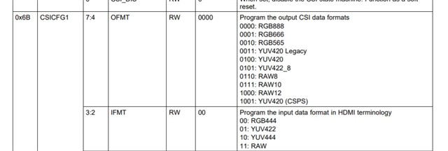

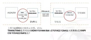

Hi team
I would like to ask that does 949 and 940 support such block diagram?
In another way to say, I have known that 949 HDMI and 940 MIPI CSI-2 both could support YuV data format, while YuV data format has different bits of data like 8bit or 12 bit and so on. So I would like to know does 949 and 940 both could support YuV all bits of data type? Thank you.
