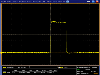

    Here is an example script used for WoL where I output the WoL pulse to GPIO_0 using a DP83867ERGZ-R-EVM Evaluation board | TI.com.
    I have verified the WoL functionality with the pattern starting at byte 62. I have included the script I used when writing to the DP83867. For further verification, I captured the WoL pulse on the GPIO_0 Pin after configuring register 0x0172. I also configured register 0x0134 to 0x0082, configuring the WOL_OUT_MODE for pulse. These are the necessary registers for the WoL feature of the DP83867 without a password in the magic packet.

    0172 0033	//Configures GPIO_0 pin for WoL Indication
    0134 0082	//WoL on pattern enabled, level Indication, pulse mode
