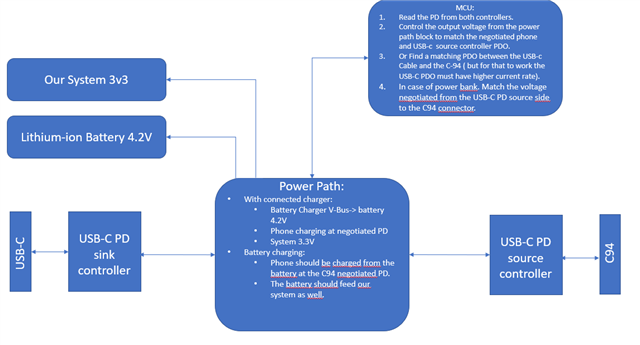

Good day. I'm posting this in behalf of our customer, kindly check the full details of the inquiry below.
We are developing an intermediate phone- case that plugs to the phone from one side and the charger from another side through C94 iPhone lightning connector and USB-C cables.
Our case has many use one of them is to be a power bank . So we have a battery installed in our case which provide the phone with Power delivery fast charge, and on the other hand, we have to charge ourselves and the phone with power delivery ( if in charge mode) . So we are a middleman between the charger and the phone in which we need to provide power delivery for our battery and the phone.
The main issue is that we are restricted to work with fast charger that comes with the phone and at the same time to provide proper PD to our system and the phone.
Restrictions we have :
- Since PD is negotiable through CC line for specific voltage and current we must insure that the PDO coming from the charger has the same voltage and higher current value than the PD of the phone ( higher value since we need to feed our system as well).
- The charger and the phone are made to work together so they have profiles that works together and by adding a power path to our system we might lead the charger to work over the current value negotiated for.
- We cannot add any BUCK-BOOST voltage regulator to match the voltage (between the phone and the charger) since we are restricted in the size of the PCB. (3A current and heat dissipation coming from other components)
What we need:
- We are working to find a way to read all the profile that the charger have and what the phone have.
- Based on (1) we will find if possible a matching profile where we have the same voltage but from the charger side a higher current rate.
- And always keep monitoring the voltage values between the charger or the phone so we can readjust the PDO whenever the external devices (phone or charger) chooses to change it.
As for the communication we are restricted to work with an MCU or if TI have a module that have in it a MCU+WIFI+(BLE5.0 >) .
If there are a solution for such request we will be very happy to hear it.
