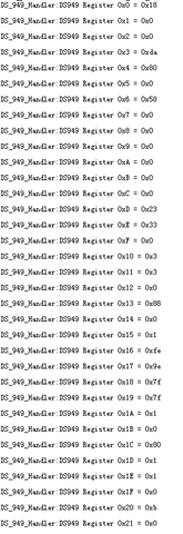

  • Hi Logan,
    The value of the 949 register is in the picture,
    Where 0x6 is des ID,
    0x8 is slave alias[0],
    0x3 is configured with i2C pass through,
    0x17 is configured with i2C pass all,
    According to the datasheet, after configuring both pass through and pass all, it is also possible to communicate with 948 without configuring des alias, but it is not, and the des alias register does not exist in the 949 register map

  • Hi Amy,
    Thanks for the info.
    Can you share what address you are trying to write/read to? Can you share a waveform/logic analyzer of a command?
    Per register 0x06, the DES ID is 0x58.
    Can you verify that the wrong address isn't being used?
    Logan
