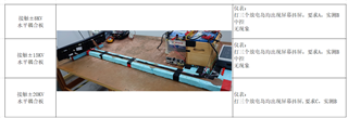

This is Chris. Recently my customer is testing ESD with our DS90UB948-Q1.
The customer is making a dashboard for SAIC and I hope you can give me some kindly help on it.
When they tested ESD of the product, they found that the dashboard screen will shake.
Below is how they test ESD of the product according to fig.1 :
  • The product is placed on a section of the copper strip and the metal frame of the product is connected to the copper tape.
  • The copper strip is divided into three discharge islands according to the distance, just as three circle.
  • The customer hits a voltage of 4kV on the middle discharge island and test the screen for abnormalities.

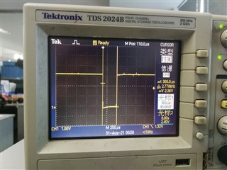

When testing the ESD, the DS90UB948-Q1's lock pin may drop down for 320us, just as below.
According to above test, I hope you can give me some suggestion on it. Or can you tell some possible reasons leading the phenomenon.

  • Hi Chris,
    Is this for air discharge or contact discharge? Can you send me your schematic for both the 948 and the SER? Can you mark in the picture where you are doing the ESD strikes?
    Michael W.

    When the lock signal drops down, by testing the register of UB948-Q1, it seems that 0x1C will change from 0x3B to 0x33. I cannot confirm whether I2S  has some influence. It is noted that I2S pin is connected with GND.
    When the lock signal drops down, the power supply will drop down, too. But the customer thinks that the time of power supply dropping down is only 100us, less than lock signal (320us).
    When UB948-Q1 works on pattern generation mode without UB941-Q1, the screen will not shake.
    Pls give some feedback on why the lock drop down so long today. And if there are any other reasons, pls share them with me.

  • Hi Chris,
    Wait, the power supply for the 948 or the 941 is dropping? if any power supply drops this would cause our part to lose lock. Also when the power supply is brought back up the 948 will take some time to relock on to the signal. 220us sounds like the amount of time the 948 would take to relock onto the signal.
    Find the root cause to the power supply drooping to fix your system.
    Michael W.

  • Hi Michael,
    On the other hand, the customer tested the power supply and the drop time of power supply is only 10-100us. I think it is less than Lock drop-down time.
    Can you give the actual phase lock time test data?
