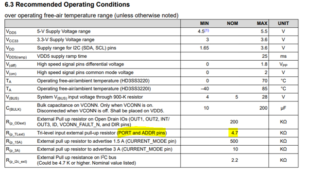

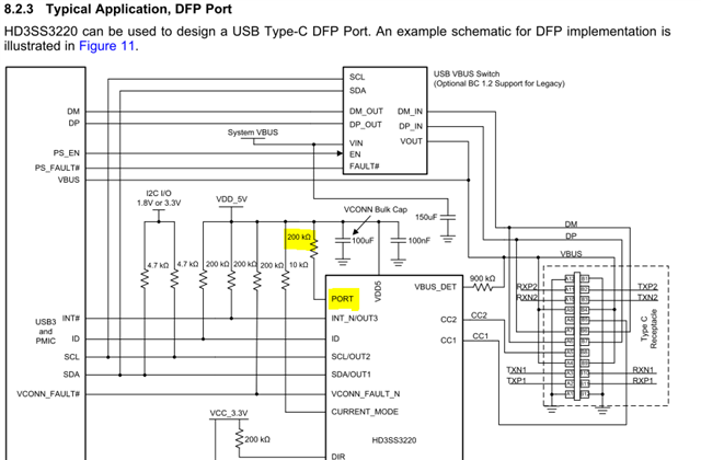

Dear Team,
I found that datasheet uses two different value of pullup resistor for PORT pin.
Could you help me to confirm which one is correct?
