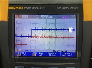

  • Hello Roy,
    So the signal above is the GPIO output from 953 to the sensor? What we need to check instead is GPIO from the 962 which is corresponding to the received LV/HV signals from the RX ports instead. So if you only have access to 2 GPIO, then you must compare the cameras to each other with only 2 ports at a time; ex. RX0 to RX1, RX1 to RX2, etc.
    Casey
  • Hi Casey,
    Thanks for information.
    We got the line valid and frame valid signal as below.
    It seems signals are not sync, how can we solve it?
    Roy
