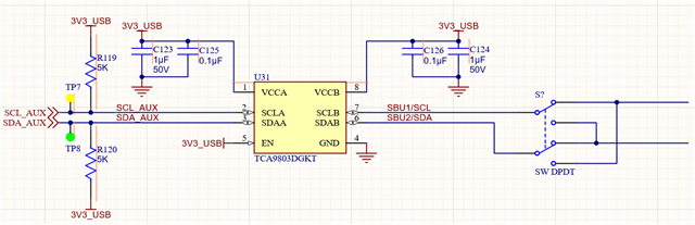

Hello Guys,
Good day.
Our customer is using the TCA9803 to drive I2C signals over the SBU1/2 channels of a USB C cable which will need to be able to swap SCL/SDA lines depending on cable orientation. They want a compatible switch that will be compatible with the current driving capabilities of the "B" side. They are looking at the TMUX1136 but believed it uses NMOS/PMOS switching so they are not sure if it will play with the TCA9803. Can you help make a recommendation? Pic below is what they are going for.
Art
