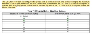

My customer want to set EDGE RATE = 000(70PS) when data rate is 12.5Gbit/s. Is it OK?

Yes, it is fine to set edge rate = 000 (70ps).
