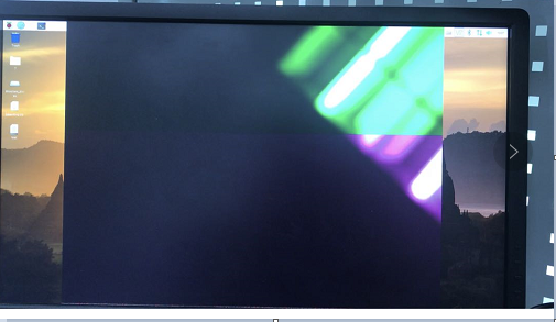

Hello, TI engineer.
        I use 953, 954, Raspberry Pi and imx477 to build my system. Now it can achieve 60 frames of 200M pixels transmission. But I use it to transmit 10 frames of 8 million pixel images, the image will also come out, but the image will sometimes appear purple bars, can you help me analyze the reasons for this purple bar? The total amount of data transmitted has not increased, and the output of 4K images is also normal when the Raspberry Pi is directly connected to the imx477.
      This phenomenon has troubled me for a long time. Can you analyze it for me?

  • Hello Kui,
    Can you please check for errors and provide us with data/values in the following registers:
    1. RX_PORT_STS1 (0x4D)
    2. RX_PORT_STS2 (0x4E)
    3. RX_FRE_HIGH (0x4F)
    4. RX_FRE_LOW (0x50)
    5. SENSOR_STS_0 (0x51)
    6. SENSOR_STS_3 (0x54)
    7. RX_PAR_ERR_HI (0x55)
    8. RX_PAR_ERR_LO (0x56)
    9. BIST_ERR_COUNT (0x57)
    10. LINE_COUNT_HI (0x73)
    11. LINE_COUNT_LO (0x74)
    12. CSI_RX_STS (0x7A)
    13. CSI_ERR_COUNTER (0x7B)
    If you provide a register dump from the DS90UB954, it will be more helpful in figuring out the issue.
