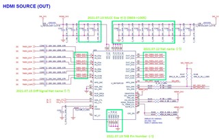

We are developing a new project for SDI to HDMI converter. See Blocks below.
3840x2160@30Hz : no problem.
3840x2160@60Hz : Depending on HDMI cable, there are various symptoms such as screen flickering, no output, and noise.
1. Is SN75DP159 sensitive to HDMI cable properties?
2. Can HDMI signals be amplified to SN75DP159?
3. Are there any schematic fix points that can improve the symptoms? Please review the schematic.
Thanks!
