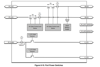

1.)I'd like to know, does this mean only 600mA current can through the CC pin?

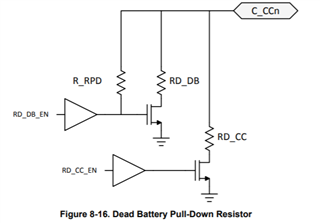

3.) What does this figure mean, I read the datasheet but I don't understand.

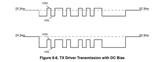

    1.  It is a data communications link to send PD messages (Question 3)
    2.  It can provide a power supply to certain cables (600mA current limit 5V supply from question 1)
    3.  It is used to determine the nature of the 2 ports connected together on the cable.  Your question 2 has some of this functionality described on it.

    1.) Why the DC bias is different, one is higher the other is lower. (Question 3)
  • Jack,
    There are 3 possible values of RP (Pull Up Resistor) and 3 possible values of Rd (Pull Down resistor)
    The type C connector uses the combination of these possible outcomes to determine the current limit for a legacy PD connection.  It can be 900mA, 1.5A, or 3A depending on the current/voltage reference.  This is described in the USBIF type C specification.

    This figure shows the dead battery case as well as a representation of the other possible resistors.
