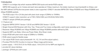

Please help to recommend TI Mipi to RGB video conversion bridge chip,Thank you
IC-MIPI TO RGB, MIPI input up to 4 lanes, RGB output up to 24 lines, QFN48, 6*6,0.75
Original model: ICN6211

There is a two IC solution to convert from MIPI DSI to RGB.
SN65DSI83 + SN65LVDS822
You can also use an FPD-Link III solution with the DS90UB941AS-Q + DS90UB926Q-Q1.
