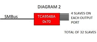

For diagram above, this has 4 slaves per output port. 4 slaves should contribute much less than max capacitance allowed per bus.
Do I need unique slave addresses for each of the 4 slaves on an output port? Or can I have same address for all 4 slaves on output port? Guessing I need unique slave addresses on bus.
Do I need unique slave addresses for each of the 4 slaves between output ports?
For instance, can I have output port 1 slave addresses of 1, 2, 3, 4 and output port 2 slave addresses of 5, 6, 7, 8? I'm guessing this is what I have to do.
I'm guessing that I need unique slaves addresses across all slaves on an output port bus, AND unique slave addresses across all output ports.
Probably looking to implement something similar to block diagram 2 above, uses less TCA chips.

  • All I²C devices on all bus segments that are enabled at the same time must have unique addresses.
    In diagram 1, all 24 slaves can use the same address if at most one port is enabled.
    In diagram 2, the four slaves on each port need unique addresses, but you can reuse those addresses on other ports if at most one port is enabled.
