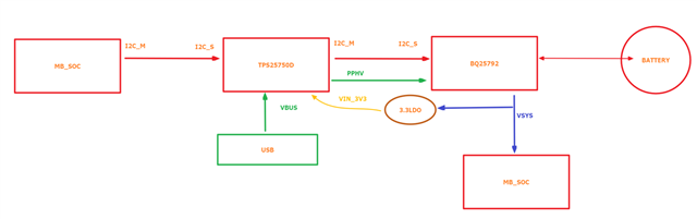

    Our customer have another question as below:
    1.Why does the PPHV not supply power when I re-plug the VBUS? In this state, why does the CC pIN stop detecting? Shouldn’t it continue to detect? No matter if I plug it or not? (in Vsys 3.3v all the time In both cases)

  • Jimmy,
    1.  Can you post a block diagram of the customer system?  I am not clear on how the part is being utilized.

  • Hi Chuck,
    Thanks a lot!!
    The block diagram is as below:

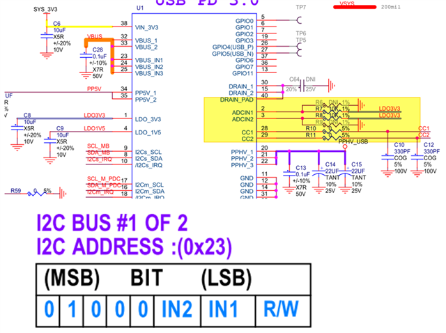

     Can MCU read or write BQ25792 configuration through TPS22750?

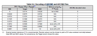

    1. Can you explain the ADCinX function and how to set the state ? Thanks!
    The I2C address is not setting as below

  • Jimmy,
    Your system is missing a 5V/3A buck converter to power the PP5V rail to allow for power source to function.
    Here are the divider ranges for ADCIN1 and ADCIN2
    These voltages set by a resistive divider can generate these modes:
    From what I can tell in your system, there are 2 possible options for you to use:
    1.  AlwaysEnableSink mode and boot from your SOC if your SOC has 16KBytes of extra memory for our config/patch file and can boot from 5V/3A
    2.  SafeMode.  This mode will require an EEPROM and will boot the TPS25750 when either VIN_3V3 or VBUS are provided to the part.
    This EVM/Reference design https://www.ti.com/tool/USB-PD-CHG-EVM-01 is a really good example of how to implement the system that you are attempting.  It will show you our recommended component set to integrate the TPS25750 and the BQ25792.
