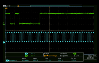

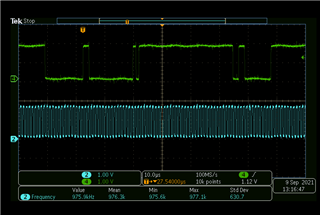

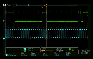

 We are trying to access the registry PMA_DEV_IDENTIFIER_1:
 On the oscillograms below the MDC clock is on channel 2, the MDIO signal on channel 1.
On attached Pictures:
-The 2 accesses in clause 45: writing the address and reading the register
- Zoom on writing the address
-Zoom on reading the register: the component does not respond:

  • Hi, see debug inputs below.
    • How are PRTAD[4:0] configured?
      • PRTAD[4:2] selects the MDIO port address. Selecting a unique PRTAD[4:2] perTLK10034 device allows 8 TLK10034 devices per MDIO bus. Each channel can be accessed by setting the appropriate port address field within the serial interface protocol transaction.
      • The TLK10034 will respond if the 3 MSB’s of the port address field on MDIO protocol (PA[4:2]) matches PRTAD[4:2].
    • Are you following the RESET_N sequence upon power up per datasheet?
    • Is TESTEN grounded?
    • Are GPI[2:0] pins grounded?
    • There are multiple power supply pins (VDDD, VDDA, DVDD, VPP, VDDT, VDDRA - VDDRD, VDDO.) Please ensure their configuration is per TI datasheet

    PRTAD[4:2] pins are grounded through  4,7KOhm resistors. TLK10034 is the only connected device on MDIO interface.
    We have probed the 32 addresses.
    The only sequence constraints I found in the datasheet is 10us minimum duration after power stabilization. Reset is deasserted by management processor after 500ms.
    TESTEN pin is grounded through 4,7KOhm resistors.
    GPI[2:0] pins are grounded through  4,7KOhm resistors.
    The  power supply pins configuration seems to me correct.

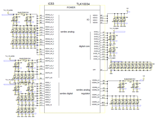

    I have perform sanity check, and I didn't find anything.
    I have try to cummunicate with TLK10034 using a Marvell MDIO probe, PHY is not responding.
    I have no doubt that on evaluation board we would be able to communicate with TLK10034.
    I get the feeling that TLK10034 is stucked during initialisation.
    Is there a way to verify that the component is initialized?
    what could block initialization?

    For MDIO, I use an opain-drain level shifter (LSF0102DCU) (The TLK10034 having a MDIO bus referenced to 1.8V,  the ethernet switches bus referenced to 3.3V).On the TLK10034 side I have pull-ups of 2kOhm on the MDC and MDIO signals.
    On the Matrix side, I have a Thevenin termination on the MDC signal and a pull-up on the MDIO signal.
    Is the MDIO part independent of the REFCLK clocks?
    Robin
