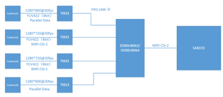

  • Customer would like to use mixed solution which means using 913 933 2*935 to connect the 964, 4 cameras used and they would like to evaluate the 2MP resolution with 30 FPS each port, could it be feasible?
  • Yes, 964 can support the resolution and number of cameras you mentioned.
  • HI Hamzeh,
    Thanks for your clarify, I also obtain the customer design consideration block diagram below:
    Besides here is our process of calculation (refer to the table below), hope you could review and correct it:

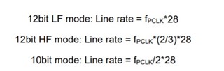

    Camera1:
    PCLK=1280*800*30*2*(1+15%) = 70.656Mhz
    FPD-LINK line rate:
    According to the range of PCLK, only 12bit HF mode or 10bit mode can be selected right?
    12bit HF mode: 70.656*(2/3)*28 = 1318.912 Mbps
    10bit mode: 70.656/2*28 = 989.184 Mbps
    CSI-2 interface bandwidth:
    1280*800*30*2*8*(1+25%) = 614.4Mbps
    Camera2:
    CSI-2 interface bandwidth: 1280*720*30*2*8*(1+25%) = 552.96Mbps
    Camera3:
    Camera4:
    Currently, there is no specific pixel format parameter, PCLK is estimated as 100Mhz of the 913 chip, and the data format is calculated according to RGB888 (By the way, could this cover the maximum data throughput of the 913 chip?)
    PCLK=100Mhz
    FPD-LINK line rate:
    According to the range of PCLK, only 10bit mode can be selected
    10bit mode: 100/2*28 = 1.4 Gbps
    CSI-2 interface bandwidth: 1280*800*30*3*8*(1+25%) = 921.6Mbps
    The total bandwidth required by the CSI-2 interface is
    614.4Mbps + 552.96Mbps + 552.96Mbps + 921.6Mbps = 2641.92Mbps ≈ 2.642Gbps
    Questions:
    1. Is this block diagram solution feasible? Could 962/964 be both proper for the solution?
    2. For this application scenario, which chip do you recommend, DS90UB962 or DS90UB964?
  • Hello Zirui,
    yes, this block diagram and configuration are supported using any UB96x Deserializer.
    I recommend you to use the UB962 since only one CSI-2 port is required. This DES is propably the more cost efective than the UB964.
    Note: from the table you have posted above, the UB913Q is not supported with the UB962 or UB964, so you shall use the UB913A instead.
