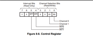

1). How is the PCA9543ADR distinguishes data between the salves (having the same I2C address) connected to its output ports?.
2). SInce BQ27411DRZT-G1A doesn't have an interrupt, I hope I can leave the ~INTx pin and `INT pin floating.
3). How can the master select slave1 and slave2?.
4).
  • 1. The PCA9543A uses simple electrical switches; all configued channels are connected together. When there are slaves with identical addresses on the downstream channels, then you must ensure that only one of them is enabled.
    2. See table 5-1; all /INT pins must have a pull-up resistor.
    3. Write a value of 1 or 2 to the control register; see section 8.6.2.
    See section 9.2 for an example.
  • Hi Clemens,
    Thank you for your quick reply.
    I hope you are referring to this
    and this
    Since my slave devices don't have an interrupt pin,
    Providing a pull-up resistance to each ~INT pin is the maximum we can do.
    What is the significance of the ~INT pin?.
    Is that just for giving an interrupt to the host MCU?.
  • Some I²C devices have interrupts. The PCA9543A allows to level shift these interrupt signals. You do not need them.
