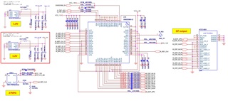

We are testing with 1920x1080 DP monitor.
But the screen is blinking.
When I checked the color bar pattern (0x3C), it was normal .
MIPI is using 890Mbps video and burst mode with 4 lanes.
Below is the I2C setting.
//// I2C set
i2c-wr 2C 0A 06
i2c-wr 2C 10 26
i2c-wr 2C 12 59
i2c-wr 2C 5A 05
i2c-wr 2C 93 30
i2c-wr 2C 94 20
i2c-wr 2C 0D 01
i2c-rd 2C 0A 1
i2c-wr 2C 95 00
i2c-wr 2C 64 01
i2c-wr 2C 74 00
i2c-wr 2C 75 01
i2c-wr 2C 76 0A
i2c-wr 2C 77 01
i2c-wr 2C 78 81
i2c-wr 2c 96 0A
i2c-rd 2C 96 1
i2c-wr 2C 20 80 07
i2c-wr 2C 24 38 04
i2c-wr 2C 2C 2C 00
i2c-wr 2C 30 05 80
i2c-wr 2C 34 94
i2c-wr 2C 36 24
i2c-wr 2C 38 58
i2c-wr 2C 3A 04
i2c-wr 2C 5B 00
i2c-wr 2C 3C 00
i2c-wr 2C 5A 0D
Which part should I check?
