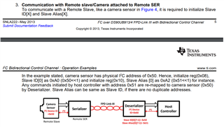

Hi Team,
My customer would like to visit 0x25 device from 954 side, which means when using i2cdetect -r -y bus_num, it could see the address 0x25.
           sensor( address 0x25)  <--->   933(address 0x58)     <---->     954(address 0x30)     <----->   CPU
Customer now configure as this document shows:
            i2cwrite  0x58 0x58     //enable pass through
            i2cwrite  0x5c 0xb0     //953 device address
            i2cwrite  0x5d 0x4a     //0x25 address
            i2cwrite  0x65 0x4a    //0x25 address
But after this configuration, customer still can't visit 0x25. Could you kindly give some advice?

  • Hello Amilie,
    Please check if they set the alias correctly? If not, follow the instructions below:
    -Des reg 0x4C: Select the right RX port to write
    -Set/Check real I2C addresses:
    -Reg 0x5B SER DEVICE ID: Set the real serializer I2C address. This is typically loaded automatically.
    -Reg 0x5C SER_ALIAS_ID: Set the serializer Alias
    -Reg 0x5D SlaveID[0]: Set the real sensor I2C address
    -Reg 0x65 SLAVE_ALIAS_ID[0] (camera alias ID): Set the sensor Alias
    - Only communicate to the serializer using the Alias indicated in 0x5C (the address indicated in 0x5C is 8-bit)
    - Only communicate to the imager using the Alias indicated in 0x65 (the address indicated in 0x65 is 8-bit)
    Also, please double check
    - The I2C pull-ups?
    - Is the imager initialized properly?
    - Does the SoC support clock stretching? The SoC needs this feature to communicate to the imager.
