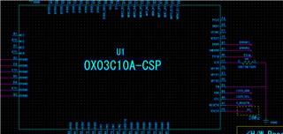

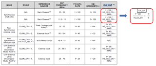

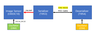

Can I use clk_out signal(Pin No.19) of DS90BU953 for CIS input clk ?
I tested this connection and checked no issue on camera operating.
If it is fine, the design is better for cost reduction.
But I concern what side-effect occur because it is for automotive.
We need to satisfy many of reliability test.
Which design is better for automotive camera ?
Add external oscillator or not use.
