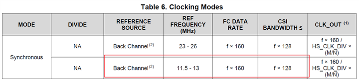

  • Hi Shruti,
    Thanks for your reply! Very clear! But I still have two other questions,
    1. In my understanding, f should be back channel rate. In the first line, back channel is 50Mbps, so f=25MHz. In the second line, back channel is 25Mbps, so f=12.5MHz. Therefore synchronous mode include two kinds of FC data rate, if BC data rate is 50Mbps, then FC=4Gbps; if BC data rate is 25Mbps, then FC=2Gbps. But in the 954 datasheet, BC data rate must be 2*REFCLK in the synchronous mode, so BC data rate only have one choice 50Mbps. It is contradictory. If BC data rate must be 50Mbps, then how do we get the second line data in the table 6?
    2. Can we use the FC=2Gbps when we use CLKOUT as a reference clock to the image sensor in the sync mode?
    Thanks & Best Regards,
    Sherry
  • Hi Sherry,
    When you select BC frequency to 25 Mbps, your BC data rate will be 1*REFCLK in the synchronous mode. There needs to be an update in the datasheet.
    Yes, you can use the FC=2Gbps when you use CLKOUT as a reference clock to the image sensor in the sync mode.
